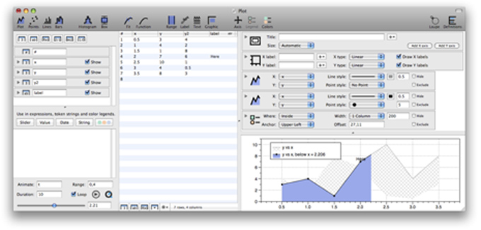

    L'interfaccia è gradevole e in linea con gli standard Apple e i comandi sono modulari e raggruppabili per ottimizzare lo spazio di lavoro

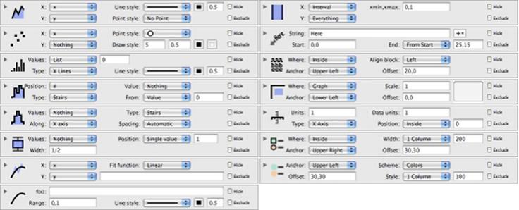

    Non posso illustrarvi tutte le funzioni del software perchè sono veramente estese. Vi allego invece alcuni brani presi dall'Help in linea che ne mostrano le principali caratteristiche:

    Below the axis commands are the drawing commands. These commands draw the content into the axis. The simplest way to craete them is to click on their icon in the toolbar, but you can also create them using the “Commands” menu.
    There are 15 drawing commands, and fall into the following categories
    Drawing data:
    Plot - The standard graph. Connect data points with straight or smooth lines.
    Points - Just draw the points. Can vary color, size based on data.
    Lines - Draw vertical or horizontal lines
    Bars - Used for bar graphs, but is similar to the plot command.
    Function - Draws an analytic function - y=f(x)
    Statistics for data:
    Histogram - Bins up a column.
    Box - Similar to histograms, but has several drawing styles but only uses one axis.
    Fit - Linear, quadratic and more. Fits an analytic function to x-y data.
    Describing:
    Range - Draws one or more regions in x/y. To highlight an interval, create alternate background etc.
    Label - Attach an arrow + text to describe an aspect of the graph.
    Text - Text inside or outside the axis. Multiple lines, used for axis titles etc.
    Axis - Very flexible axis, can be added inside the graph, use different units etc.
    Graphic - Paste in a bitmap, pdf or another DataGraph graph.
    Legend - plot legend.
    Color Legend - Describes color schemes.

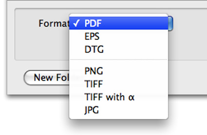

    Graphics File:
    To export a bitmap or vector graphic, select “Export Graphic...” from the File menu.

    And select the format

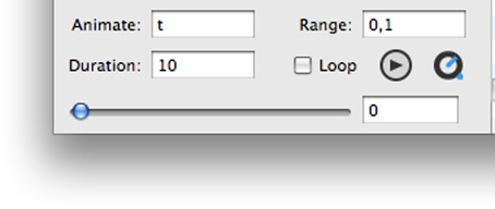

    QuickTime:
    Once an animation has been set up (explained here) it is saved by clicking on the QuickTime button to the right of the play button.
